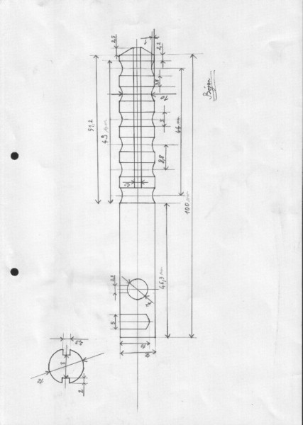

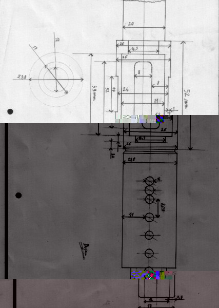

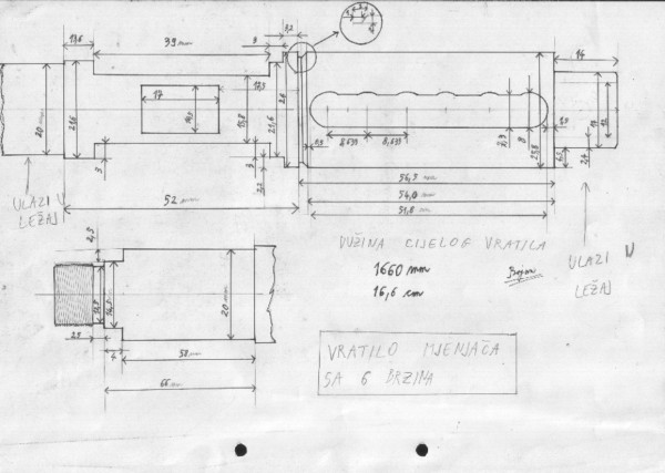

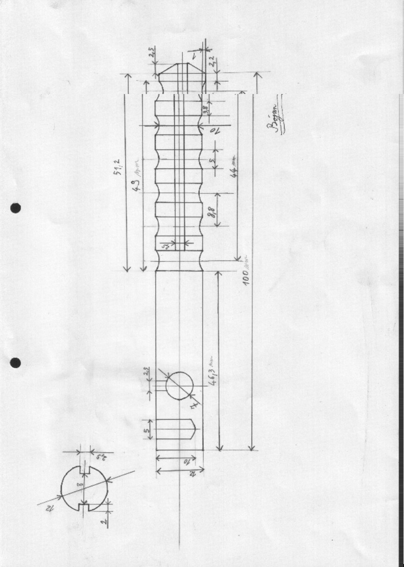

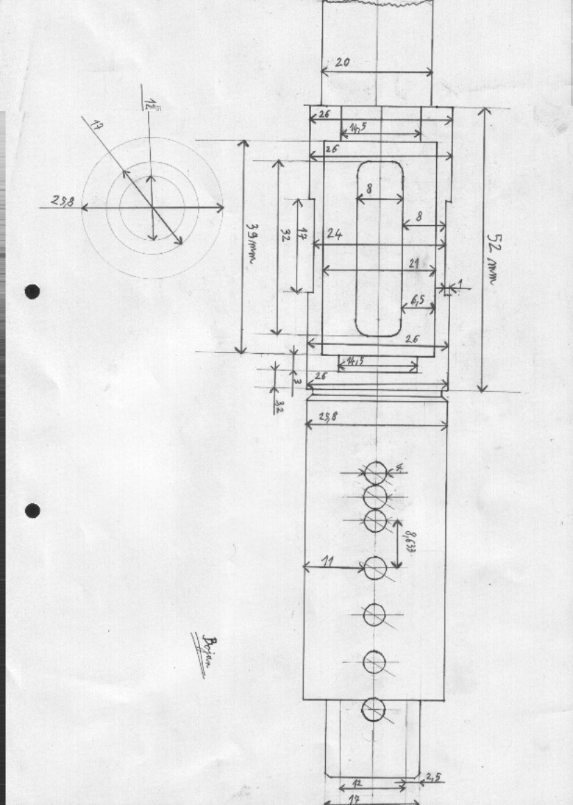

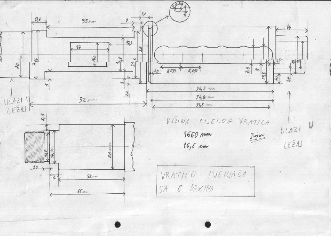

Hi!
I started working on 6speed gearbox about 1/2 year ago.
if you want good acceleration and speed, you will need right gear ratio's
My gearbox, unfinished 5 and 6 gear pairs
My machine: (unfinished coz of other projects...)
A35 tunned cly 38.5
homemade ignition
homemade exhaust
6speed gearbox
In the future, maybe, i will make D6 replica
I hope you will succeed!
