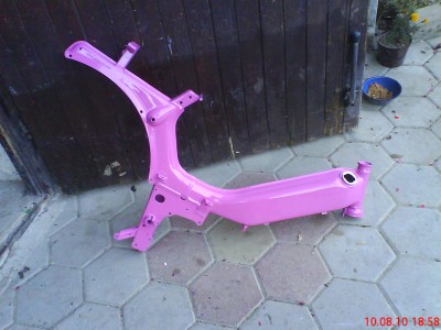

at the start it was just an wrecked moped but my plans were that i make it live again:
and after cleaning :
after painting :

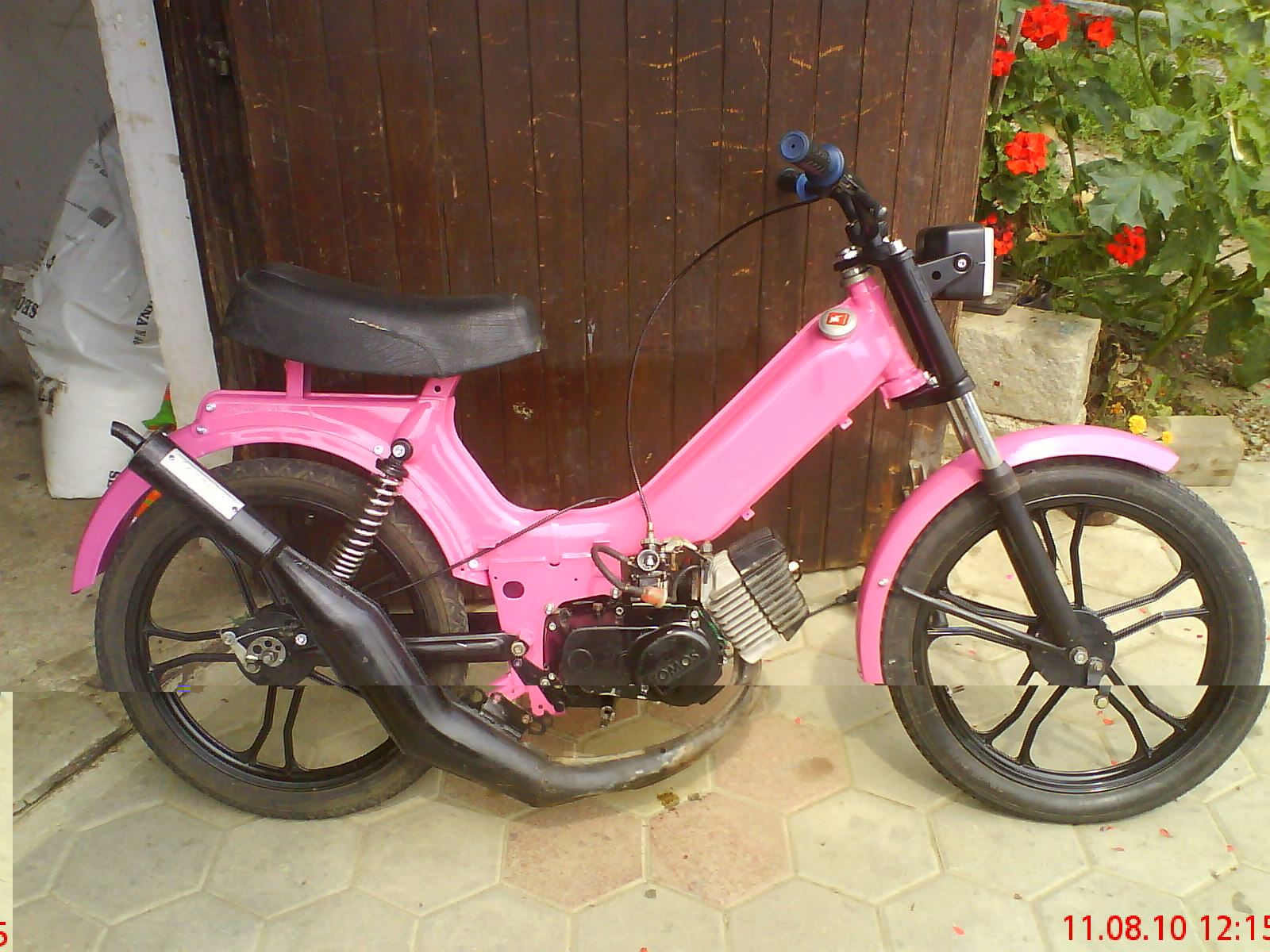

there it is finish but it was not so pretty that I thought so i go on ...

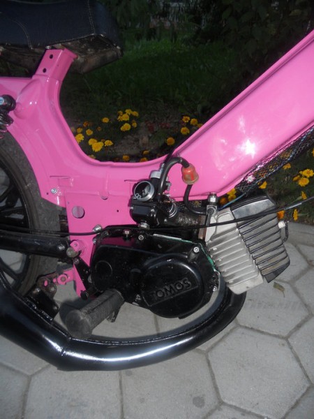

new carburetor
front disc

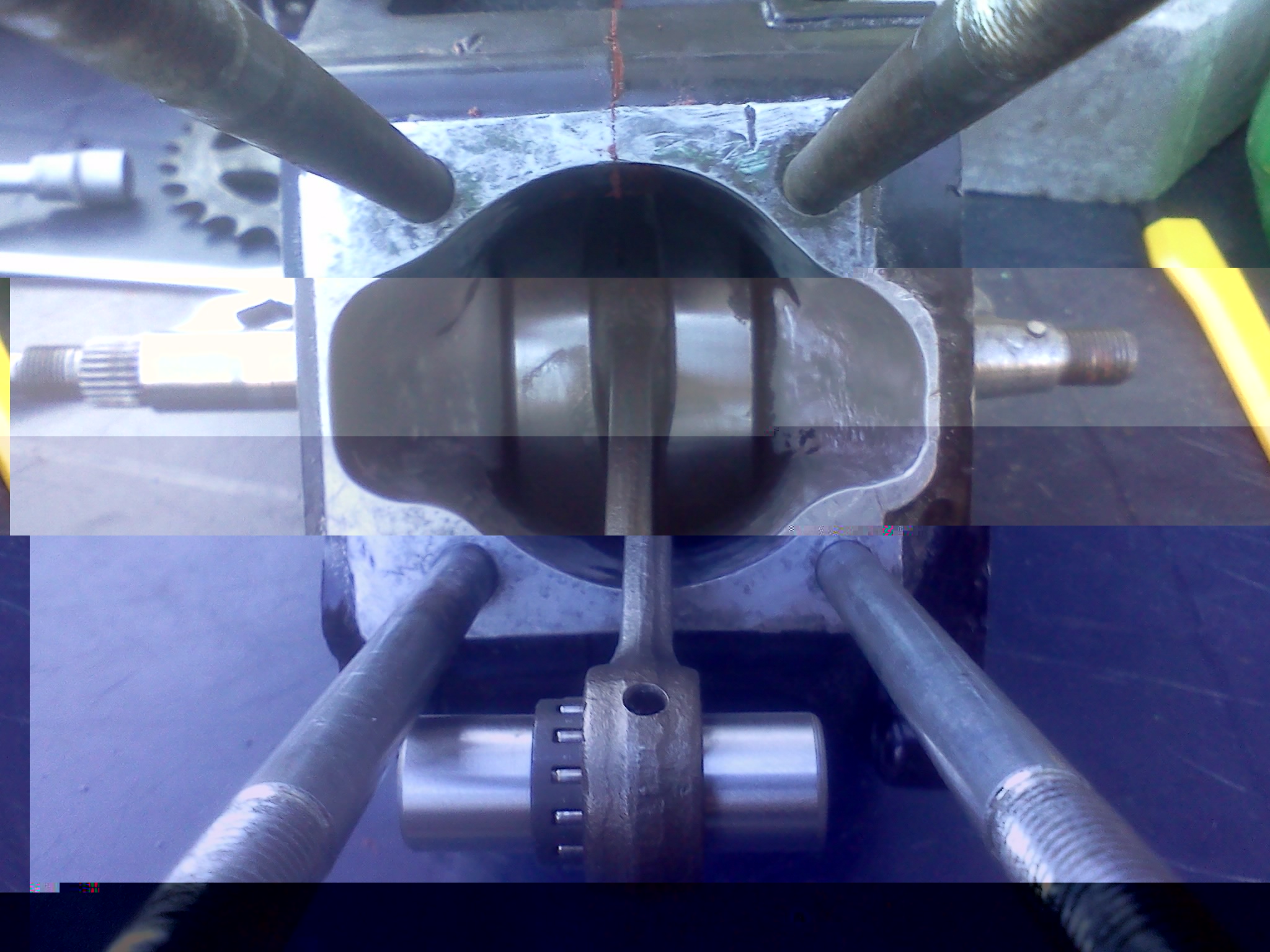

so the airsal wasn't enough so I buy DMP 70 on the puchshop.de
this is it :mrgreen: some pictures are not in the right positions i'm sory.

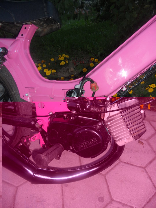

I wish our country sold the exhaust on the fifth picture. What's the name of those again.. Something with ninja or something I thought.

met die pijp kon je wel eens aan de grondlopen,is al eens gebeurt zo te zien?..Does that exhaust fit on a tomos?,because it looks as it is going to touch the ground if you make a turn or hit a bump in the road.

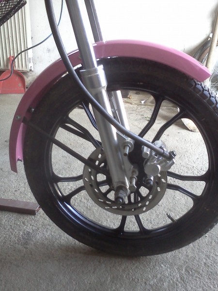

Ik denk niet dat die pijp tegen de grond aan loopt, mijn terugloop zat ook op die hoogte en een homoet is ook aardig laag.
Nice disc break. Did you make the adapter yourself?

ik vind die pijp op de bovenste foto's echt mooi,
Dat is een MF Power Pipe.
thanks
this exhaust is the MF power model 3 :)
a couple of times I pulled it to the floor so then I bent it higher, here is one picture to present :
no there is no adapter this rim because this is not the front rim but the back, so i got two back rims on the moped and the Screws for the Sprocket on last rim are increased so the holes of the disc match with the holes on the rim and this is it. the front forks are from the china cross named "bemi 110 ccm".
