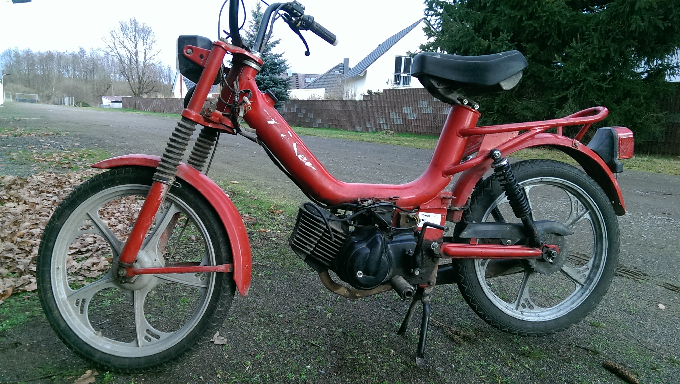

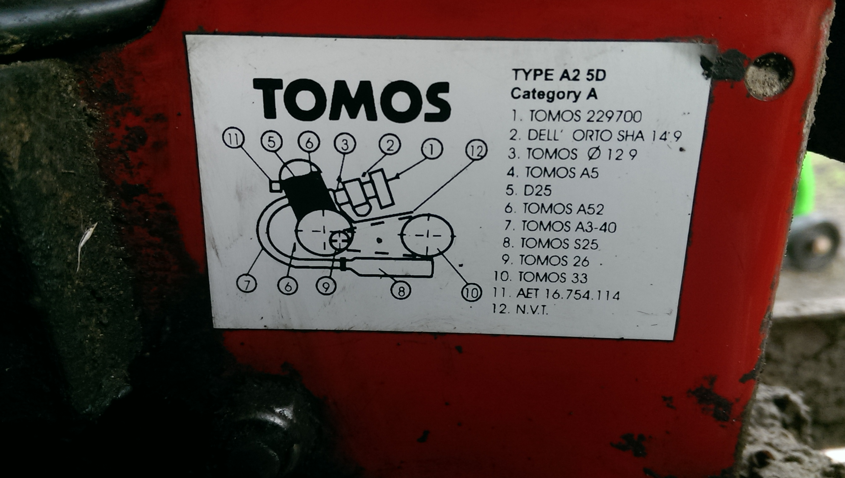

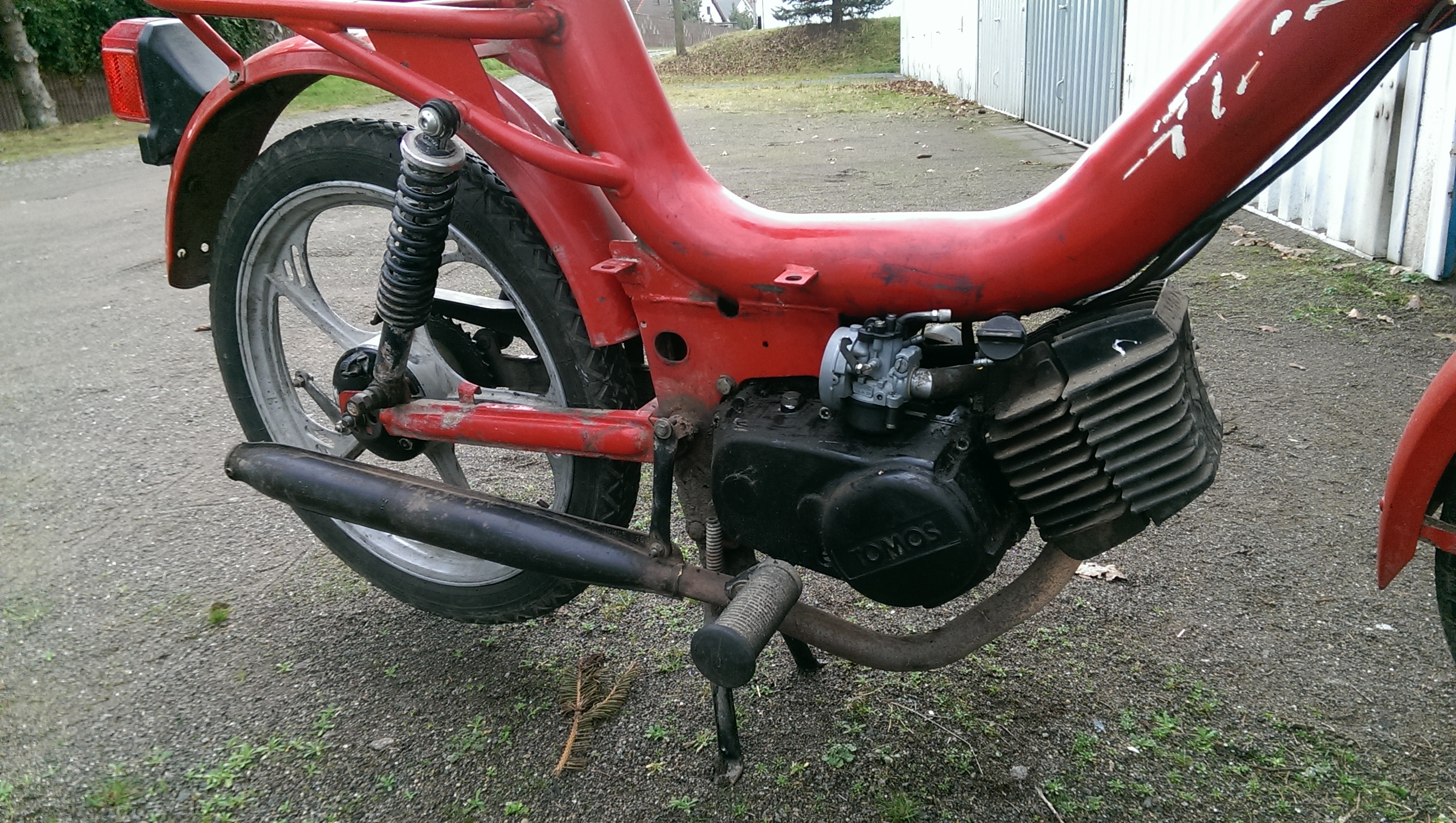

I am new here and I think it's time for short presentation. My name is wolfram and I have some old cyclomoteurs like Peugeot 193 and so on. I live in Leipzig and I have a passion for old motorcycles. End of last year my neighbor gave me a tomos in some sad condition. So I decided to put some work on it and get it running.
I'm not sure what year it is.
It's a flexer and the cylinder says A5. I could start without the carburetor...

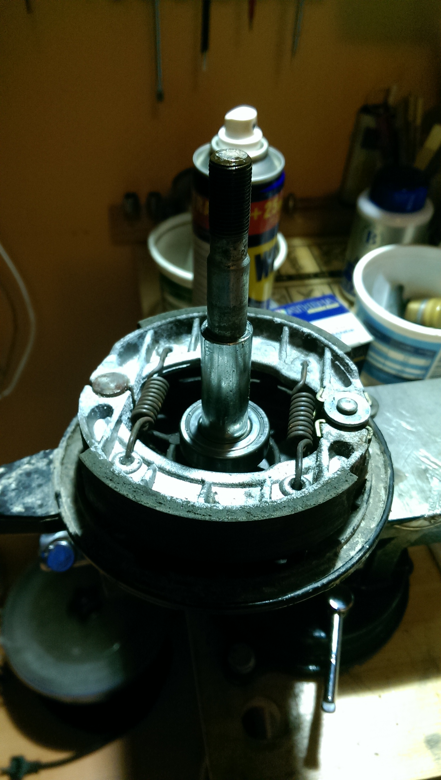

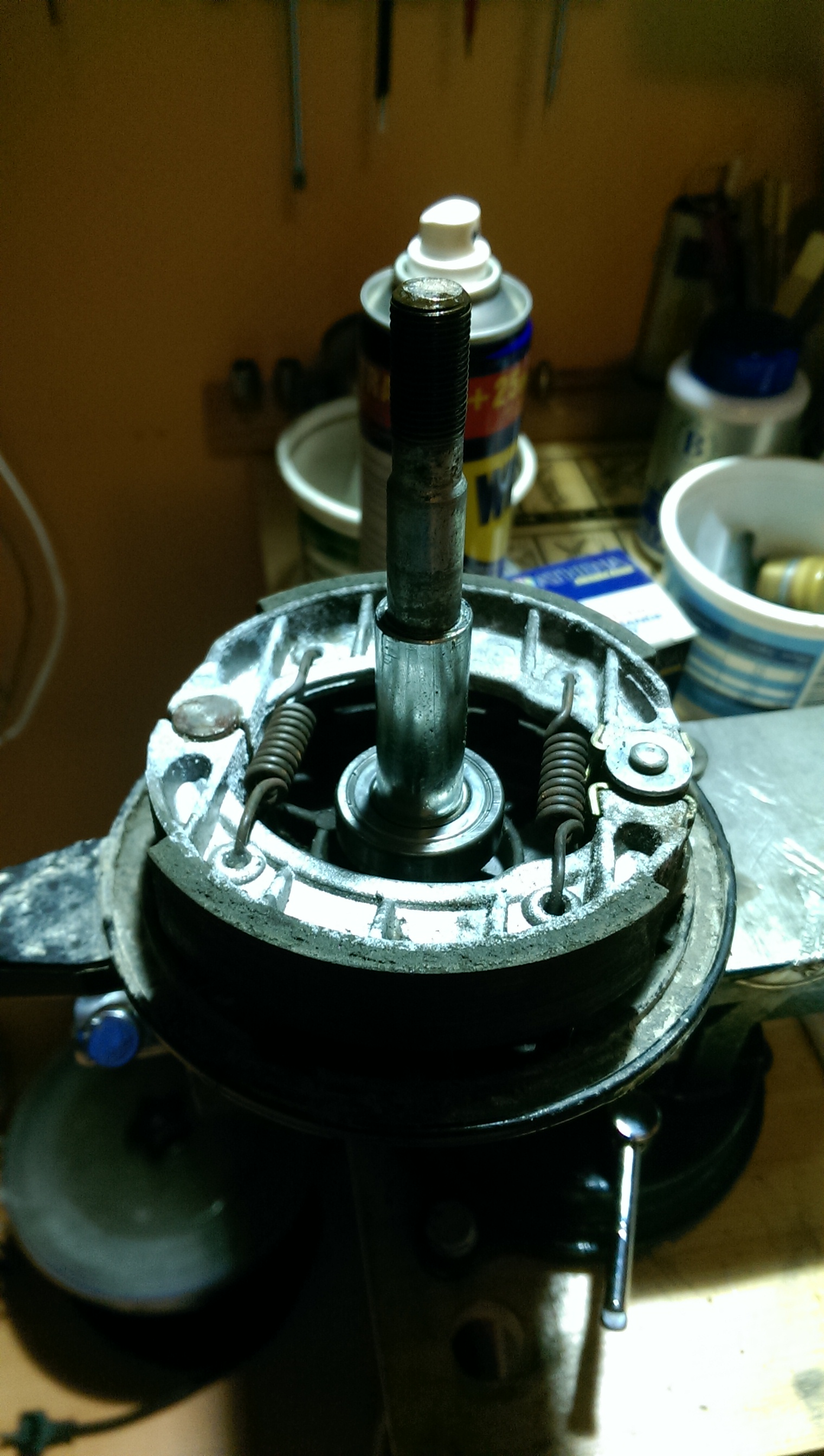

Today I spent some time with the front wheel, the inside was corroded and nothing turned anymore. With plenty of ballistol and sandpaper it's working again :)

Tomos itself is bankrupped, so don't expect to get some info there. Papers were never issued off factory.

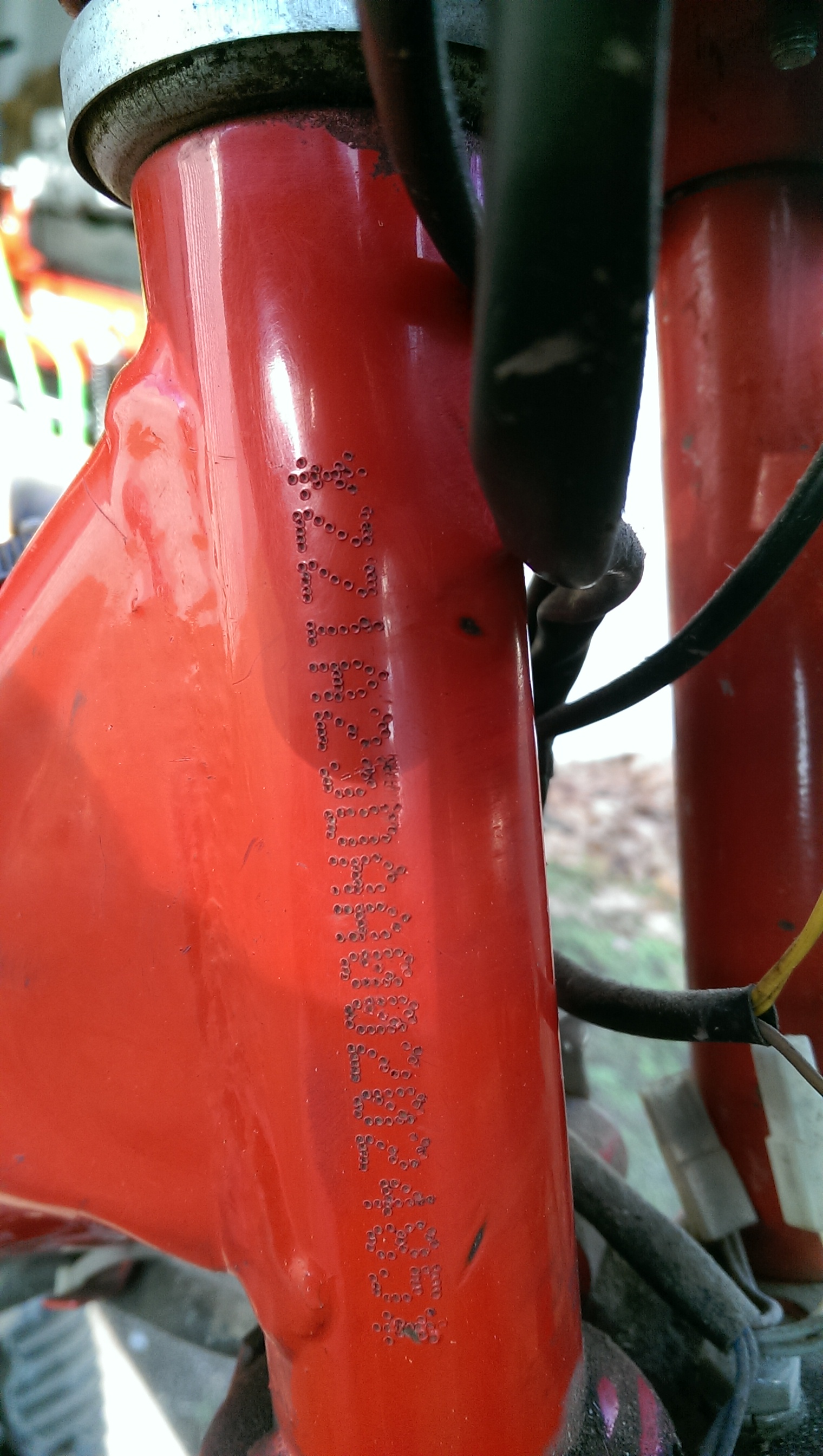

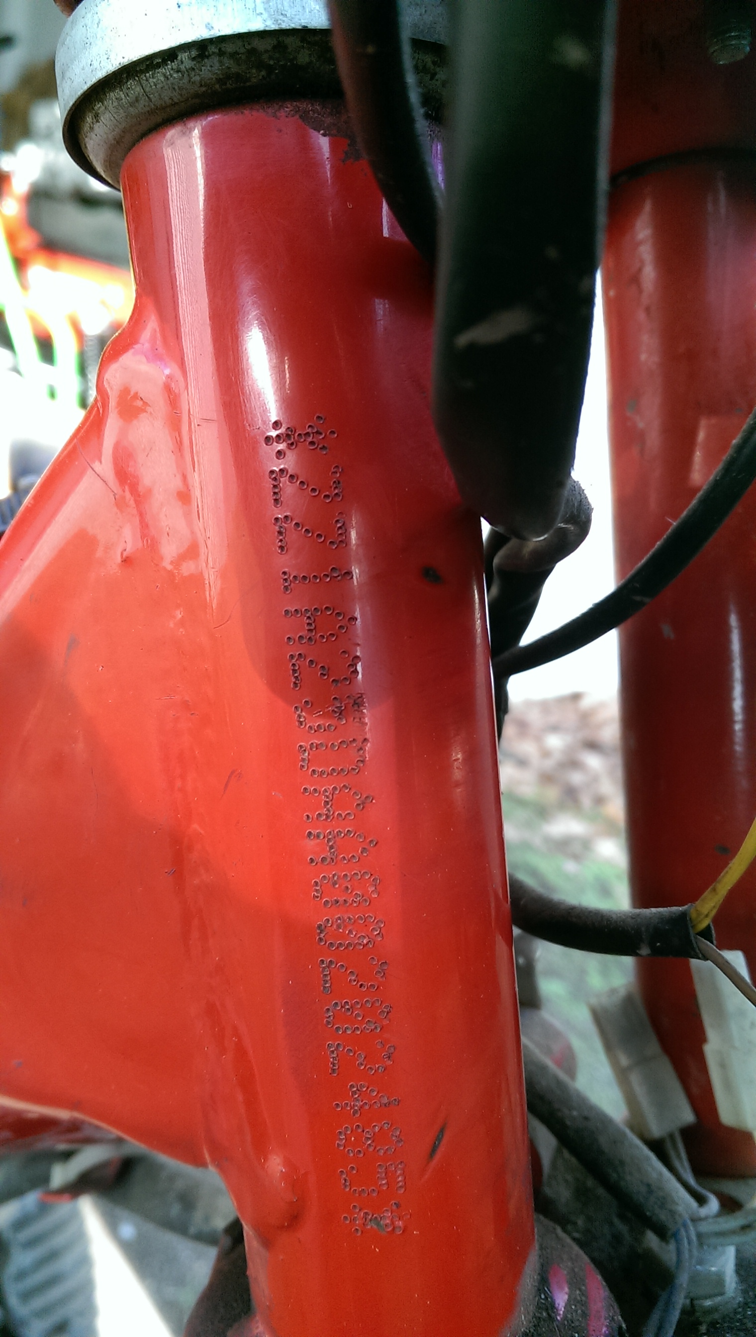

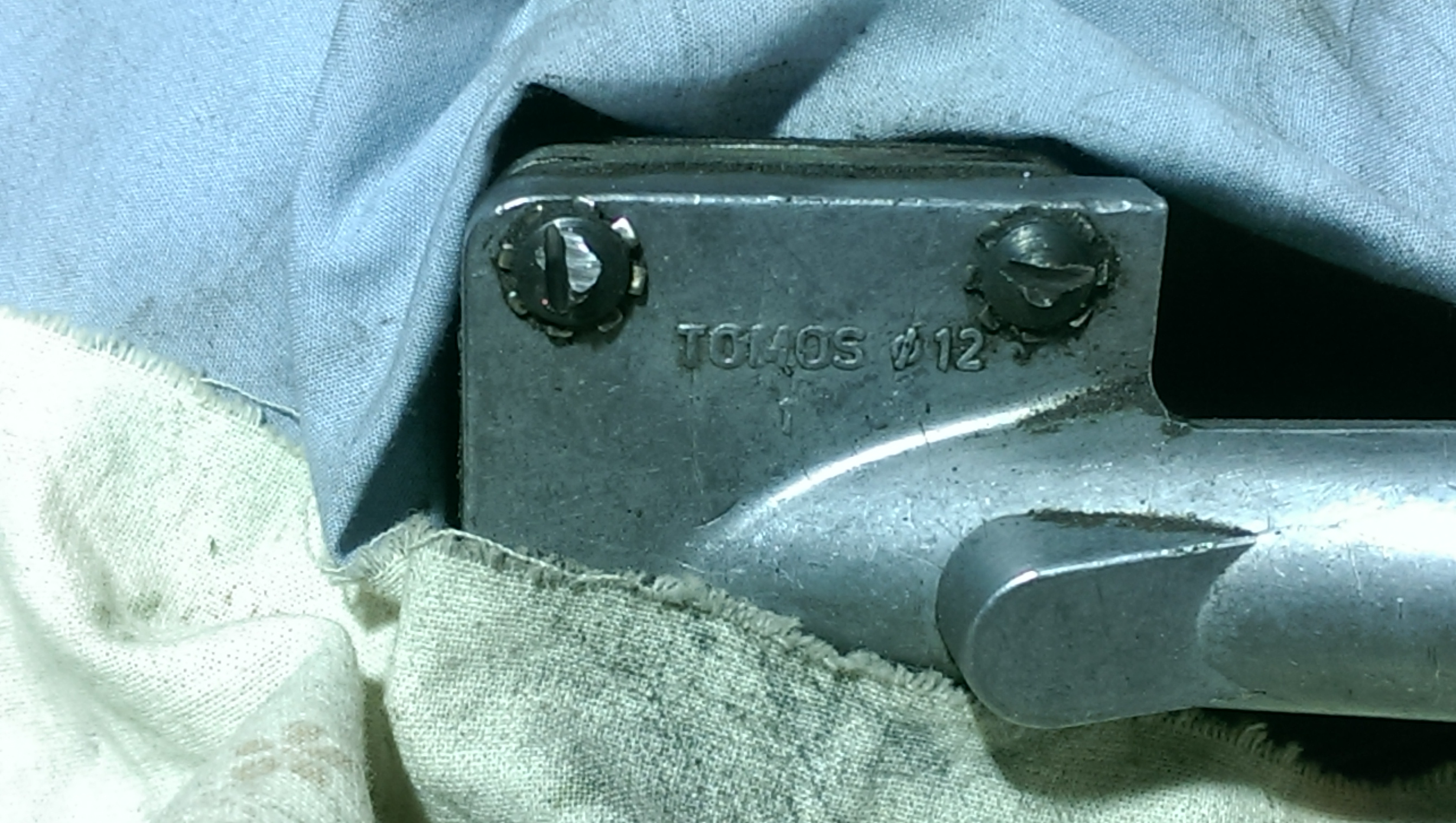

About your first picture, that's your frame number that TuV will need when you want to make your Tomos legal with papers. In Holland is the same price when we have to go to a similar institute called RDW. Maybe you can find an other number on the opposite site with a circle and EU or countrycode. (e.g. DE or NL) which is the type approval.
Brakes are the worst because of aluminium and they corrode like hell when not taken care of properly

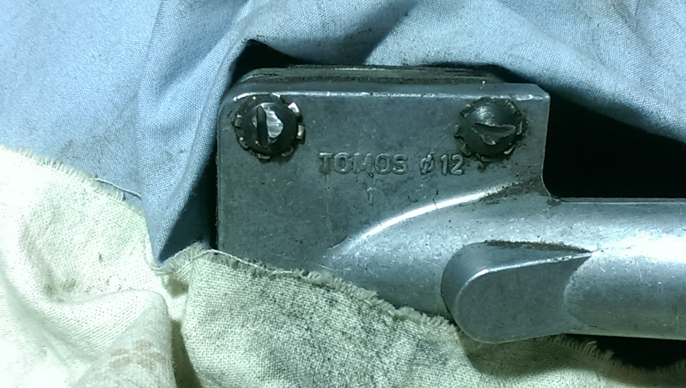

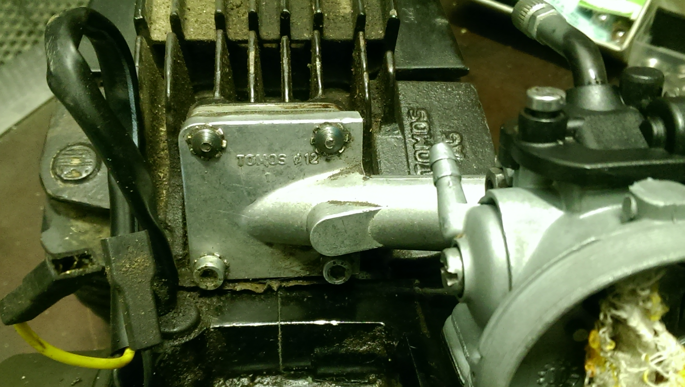

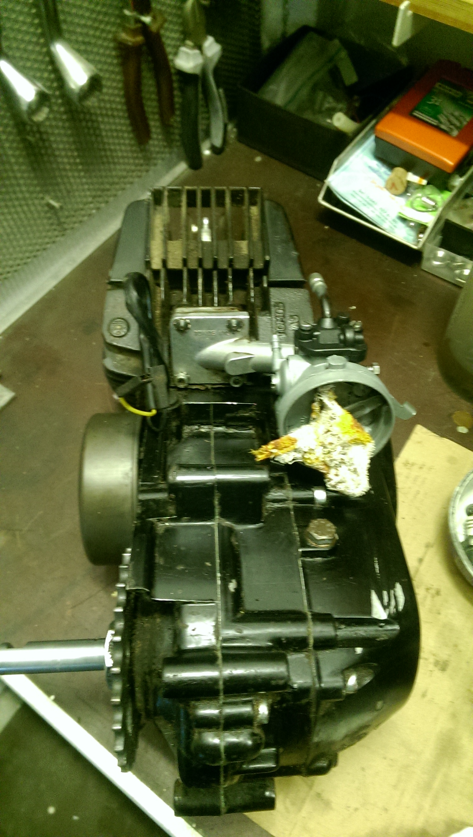

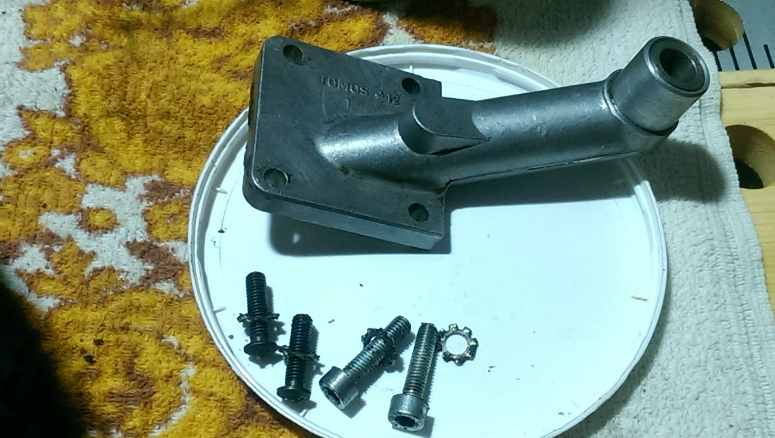

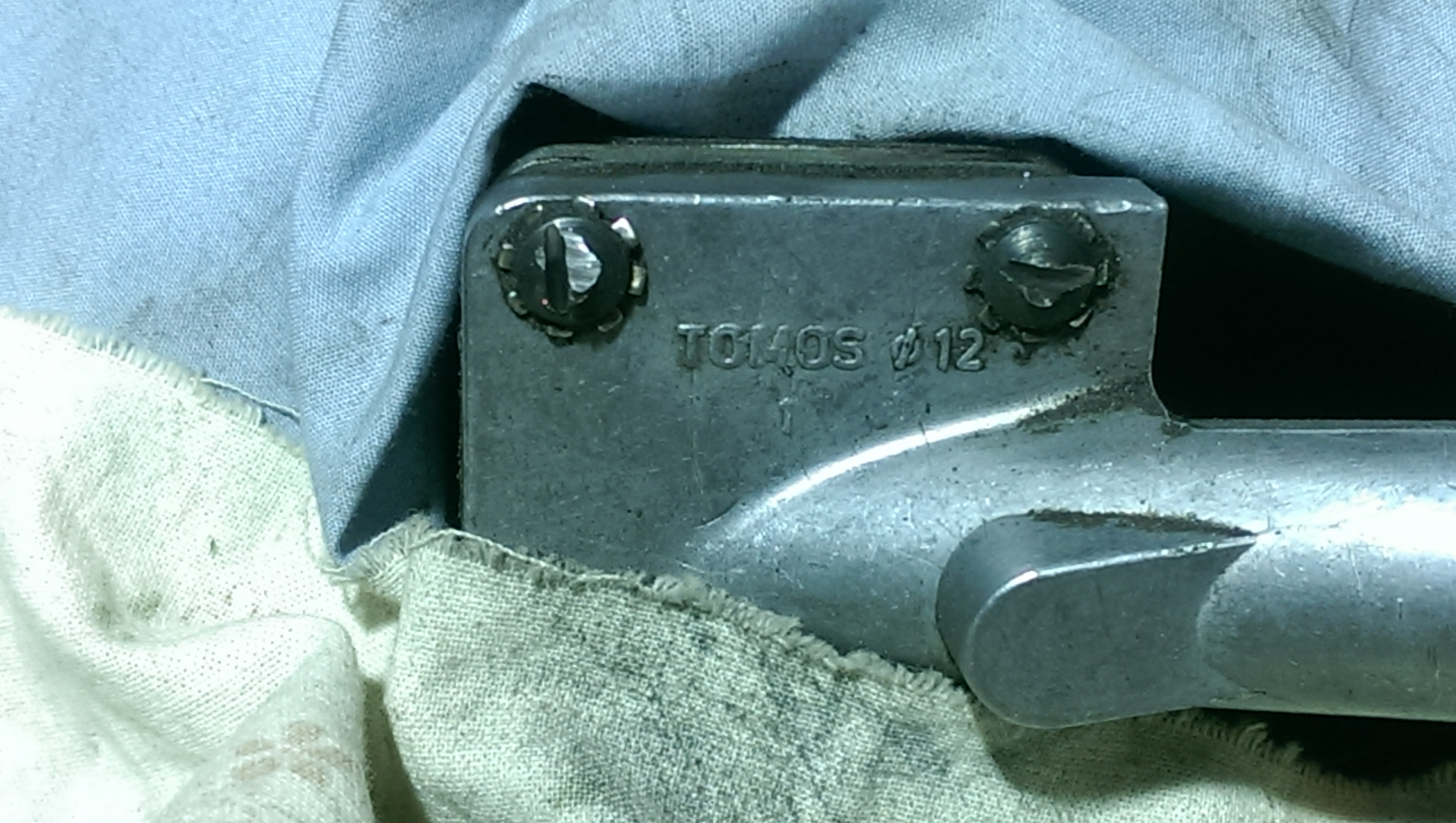

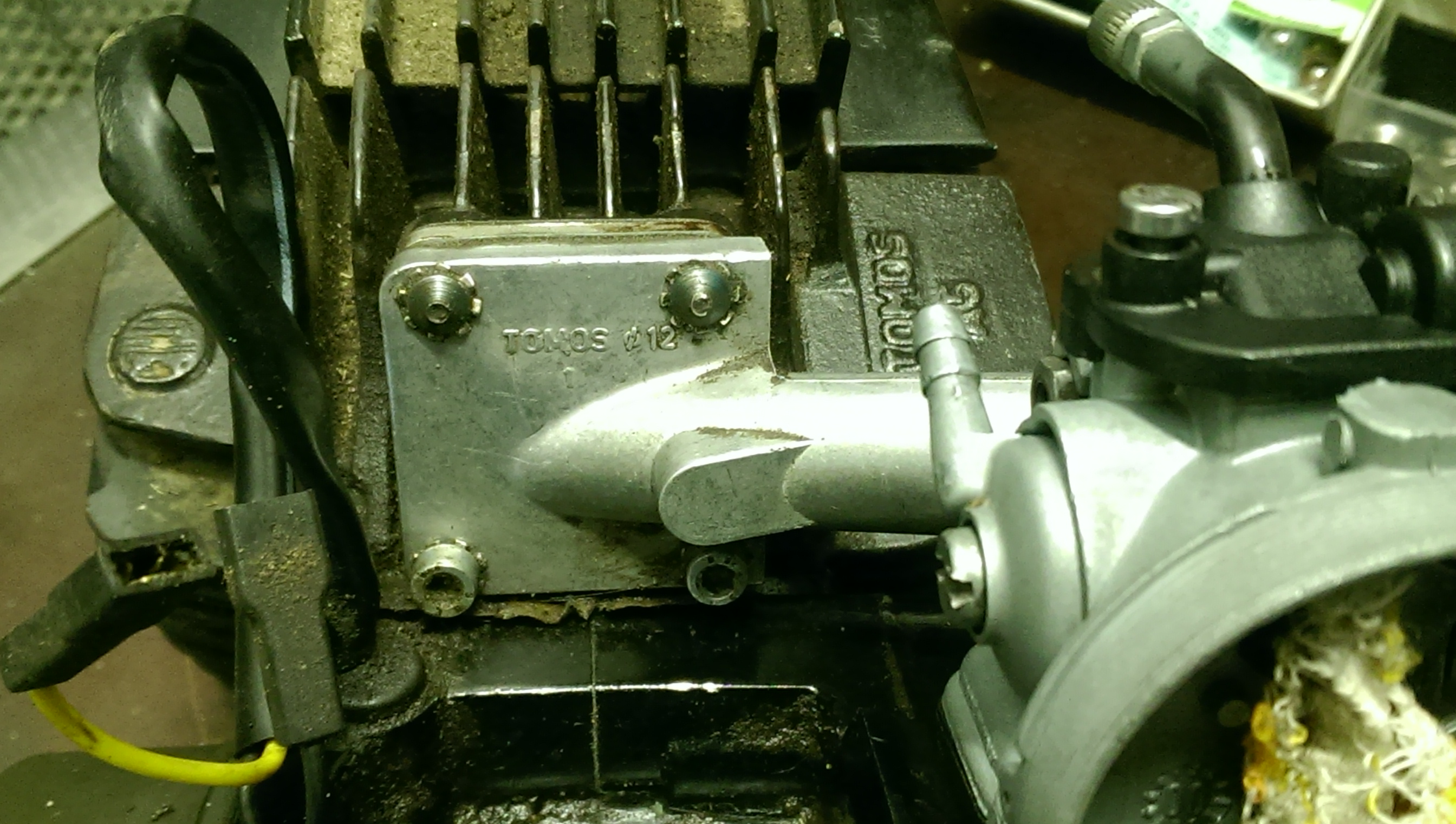

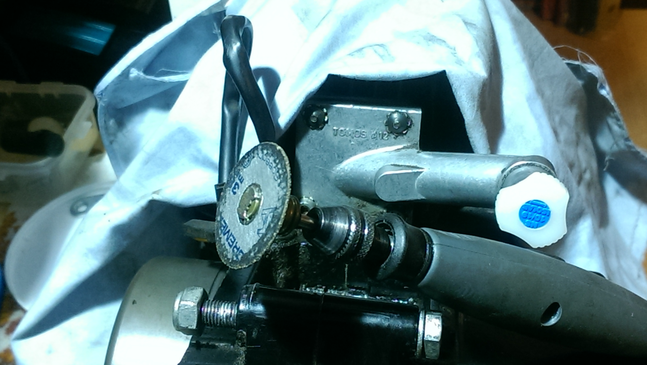

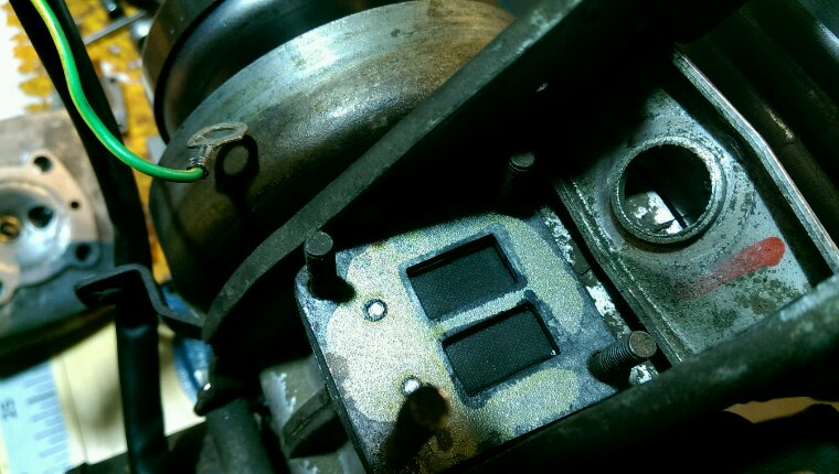

The motor is out and I wanted to replace the seals. But there are two screws at the manifold that looks weird. How can I take those two things out w/o making damage to the cylinder? Do they need to be drilled out?
This manifold is much too small and I want to replace it to inhale a bit more power to the engine.
Ciao wolfram
Berichten: 3896
Berichtdoor fons716 » 16 jan 2022 20:05
You can grind a slot in it with a dremel for a flat head screwdriver.
You can pull the bus out of the manifold with some homemade tools
Heat the manifold well, or use a pipe with a ring...otherwise the manifold may break

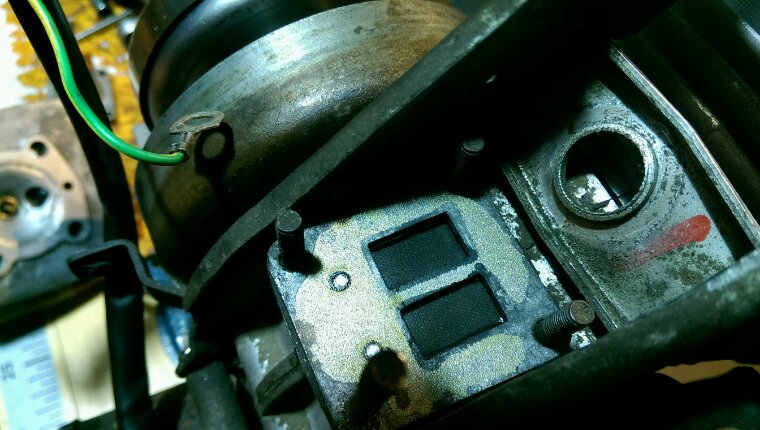

Seems to me that the reed valve has the same dimensions like those from my Peugeots.

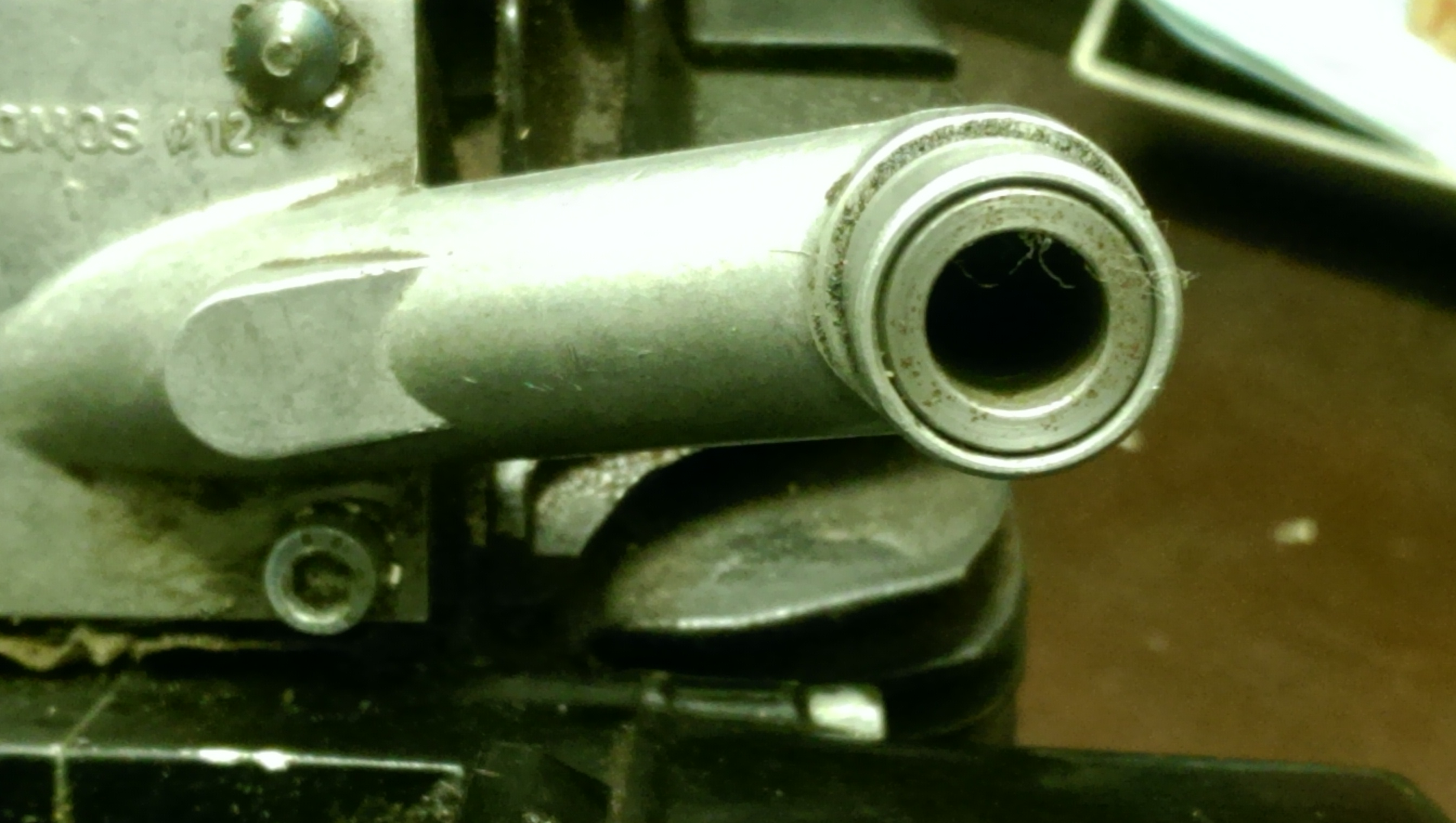

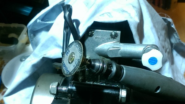

Berichtdoor Wolfram » 29 jan 2022 22:02

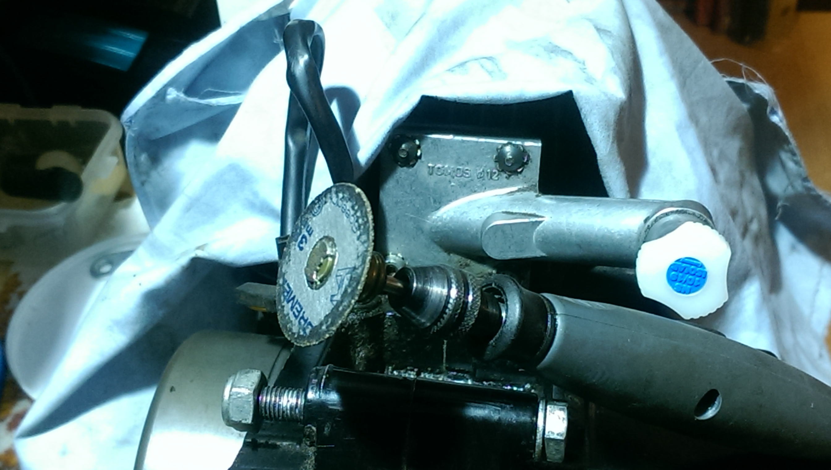

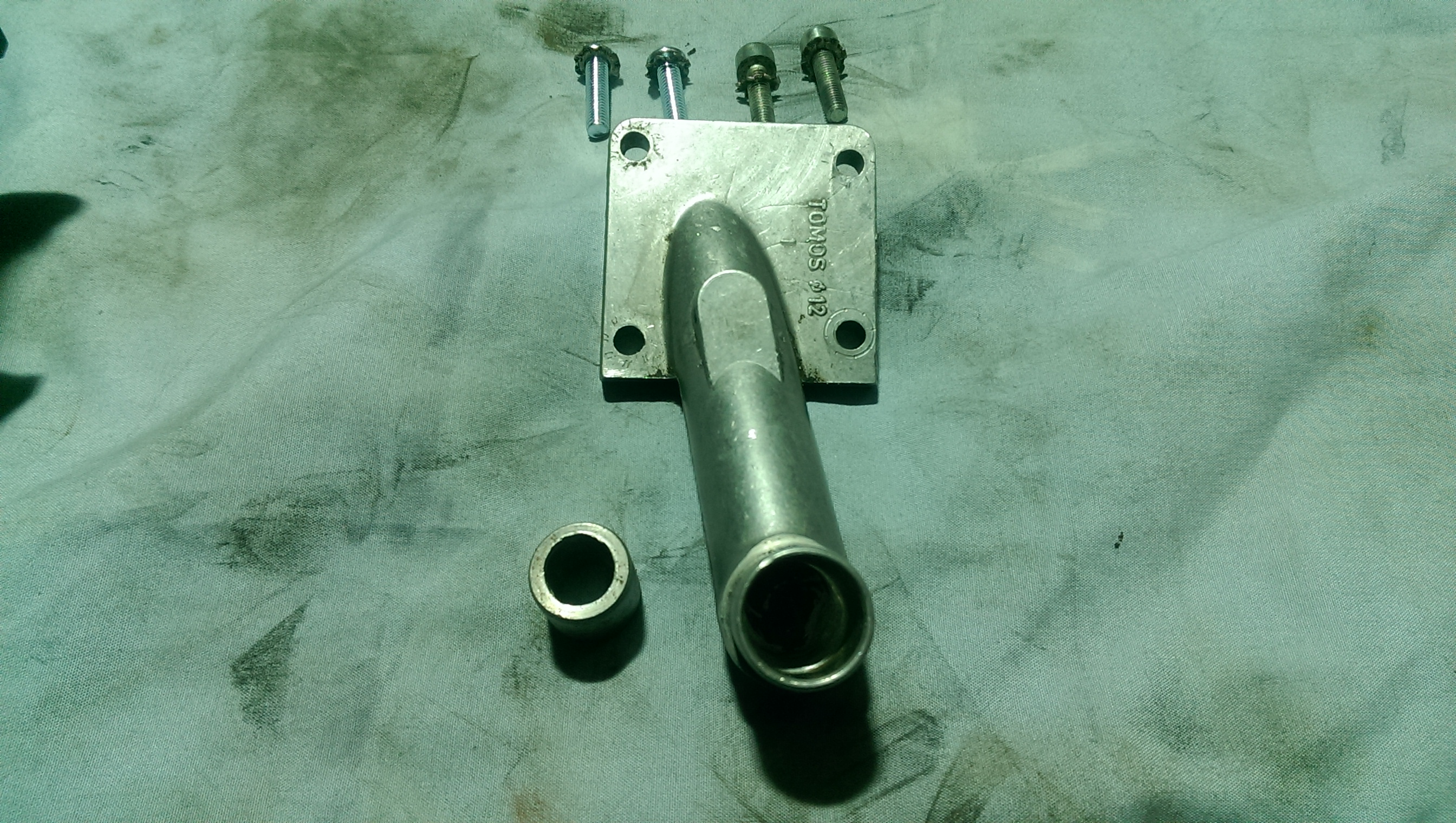

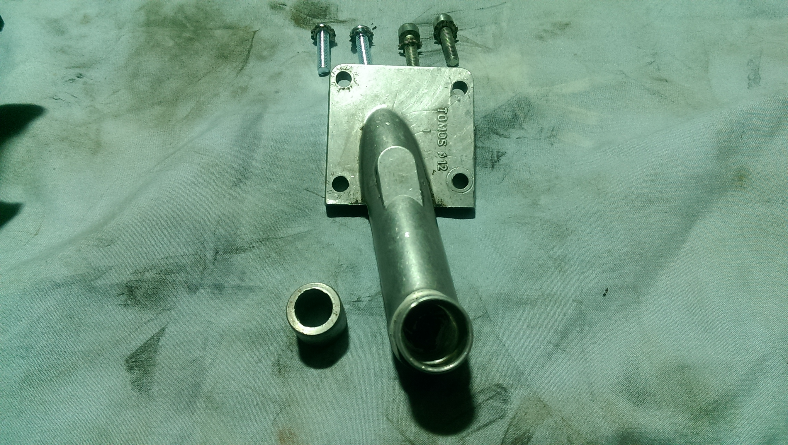

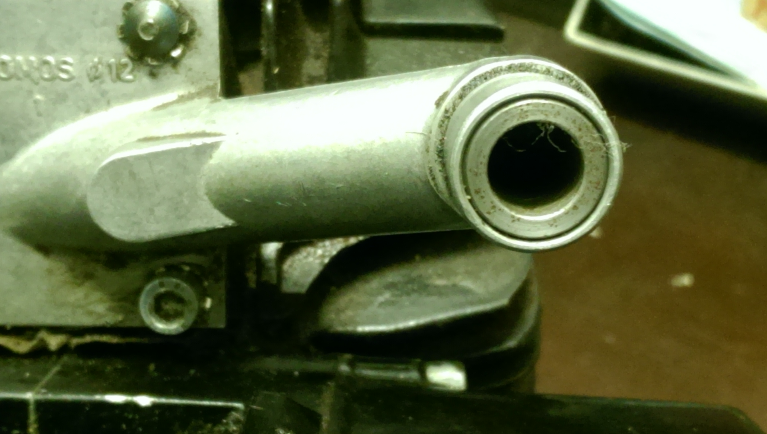

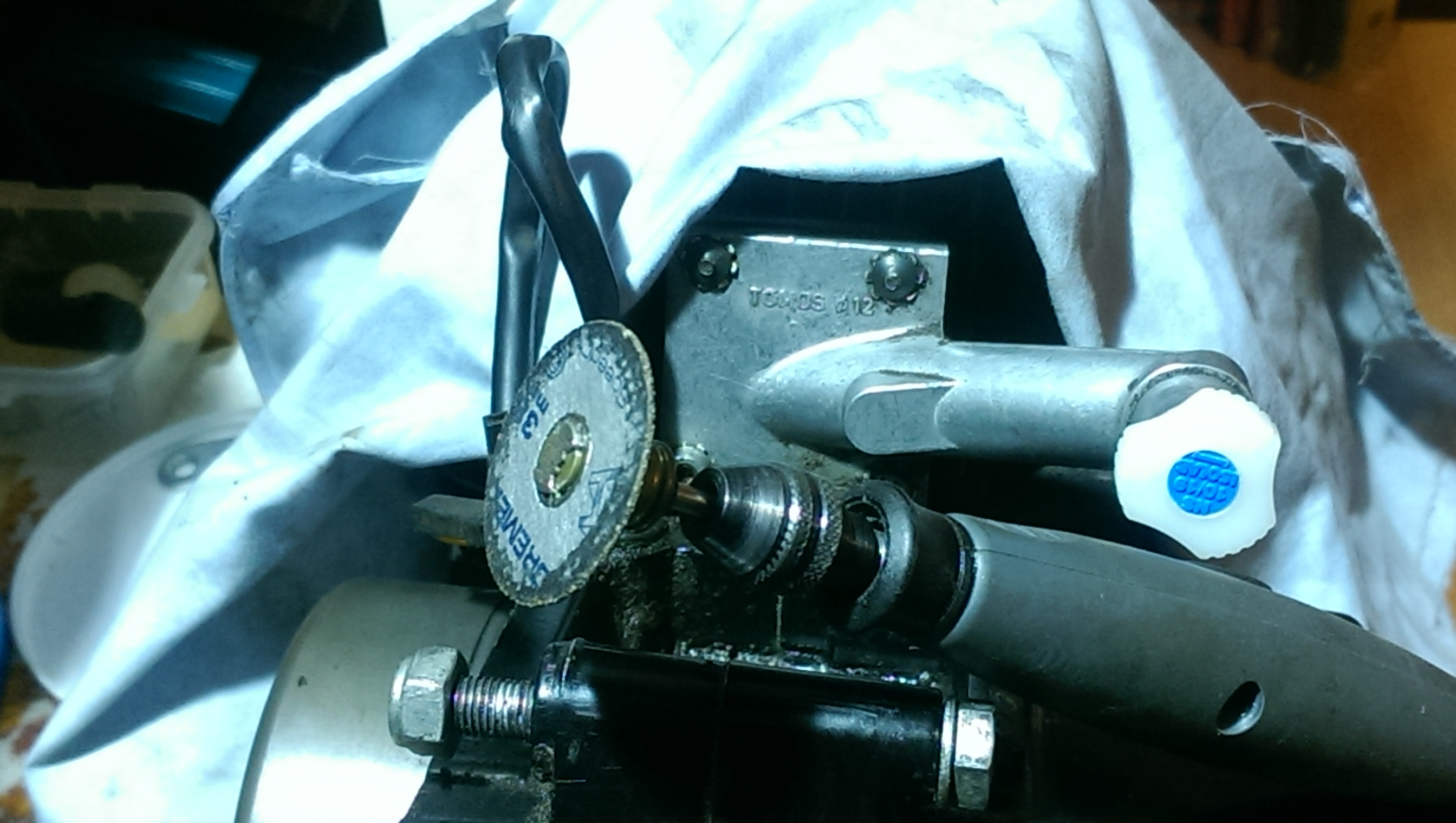

Update: the manifold has been removed after cutting the screws without head with the dremel. Now it comes to remove the reduction ring inside of the manifold...
Ciao wolfram[attachment=2]IMAG1077.jpg[/attachment][attachment=2]IMAG1077.jpg[/attachment][attachment=1]IMAG1078.jpg[/attachment]
Berichten: 3896
Berichtdoor fons716 » 30 jan 2022 10:30
Heating the manifold to 200 degrees and turning an old Thread Tap m10 in it sometimes also works.
Or slide a tube of 18 mm inside of 5 cm long on the manifold and a carriage bolt m5 x 80 and grind the head back to 9 mm so that you can hook it behind the bush, put the washer and nut on it and you pull it out.
Wolfram
Berichten: 25
Lid geworden op: 08 jan 2022 17:20
Berichtdoor Wolfram » 30 jan 2022 14:22
Salut,
I used a screw M6 with the corresponding nut on the other side of the reduction ring.
After heating the manifold with a heatgun from all sides, one clash with the hammer and the incrustation came out.
Now I'm going to inspect the cylinder...

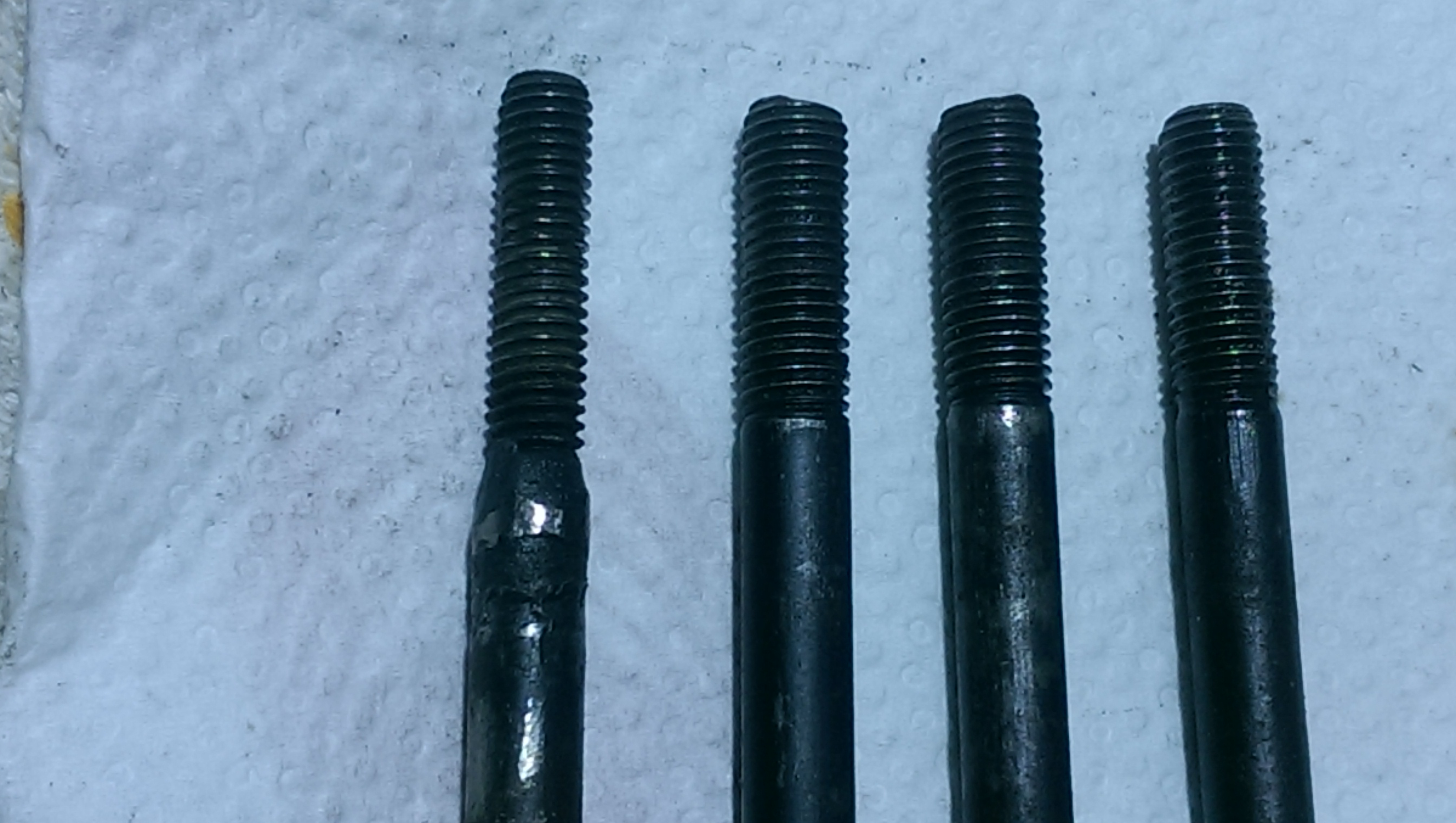

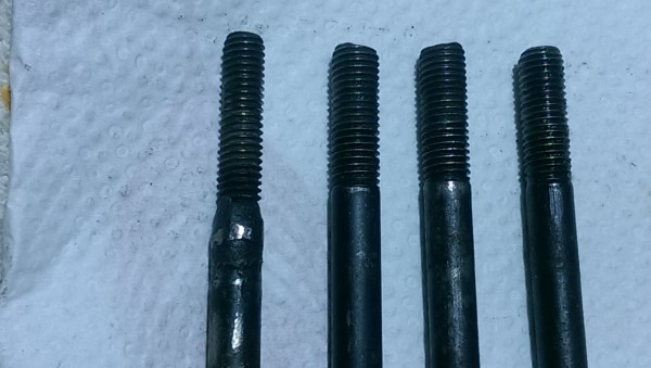

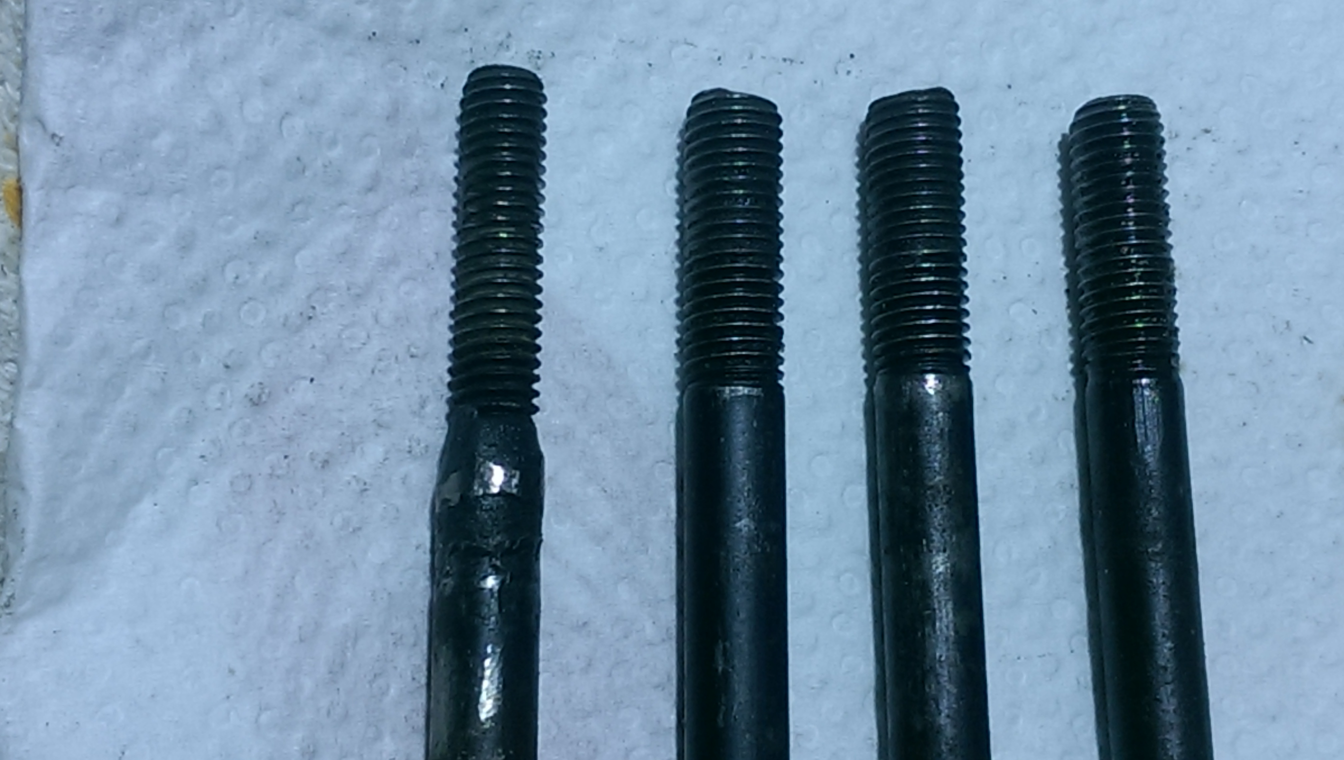

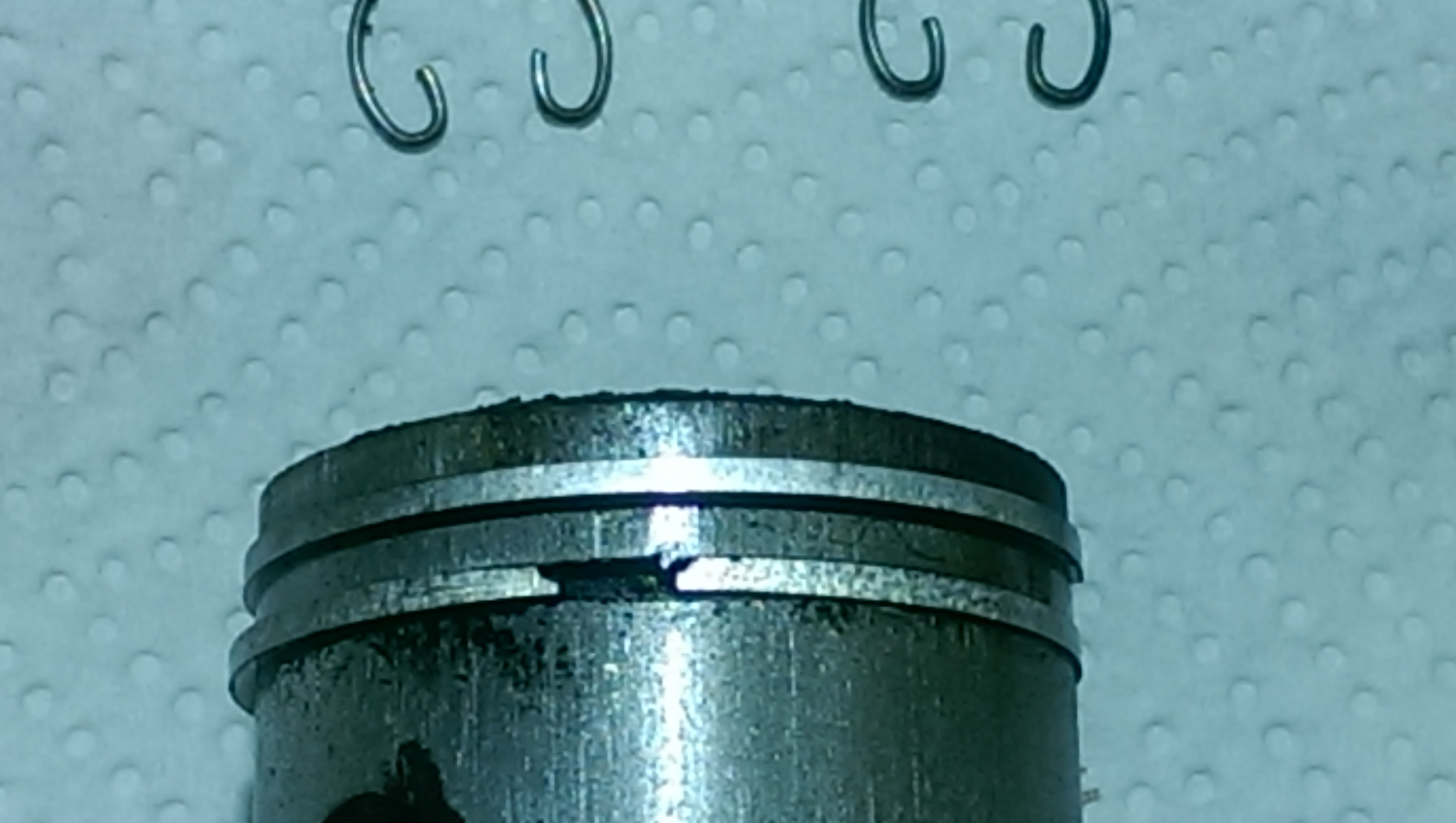

Cylinder and piston are removed. One screwbolt has been fixed by welding and instead of M7 it has M6 on the end... :(
I hope that I can use a bolt of my Peugeot instead.

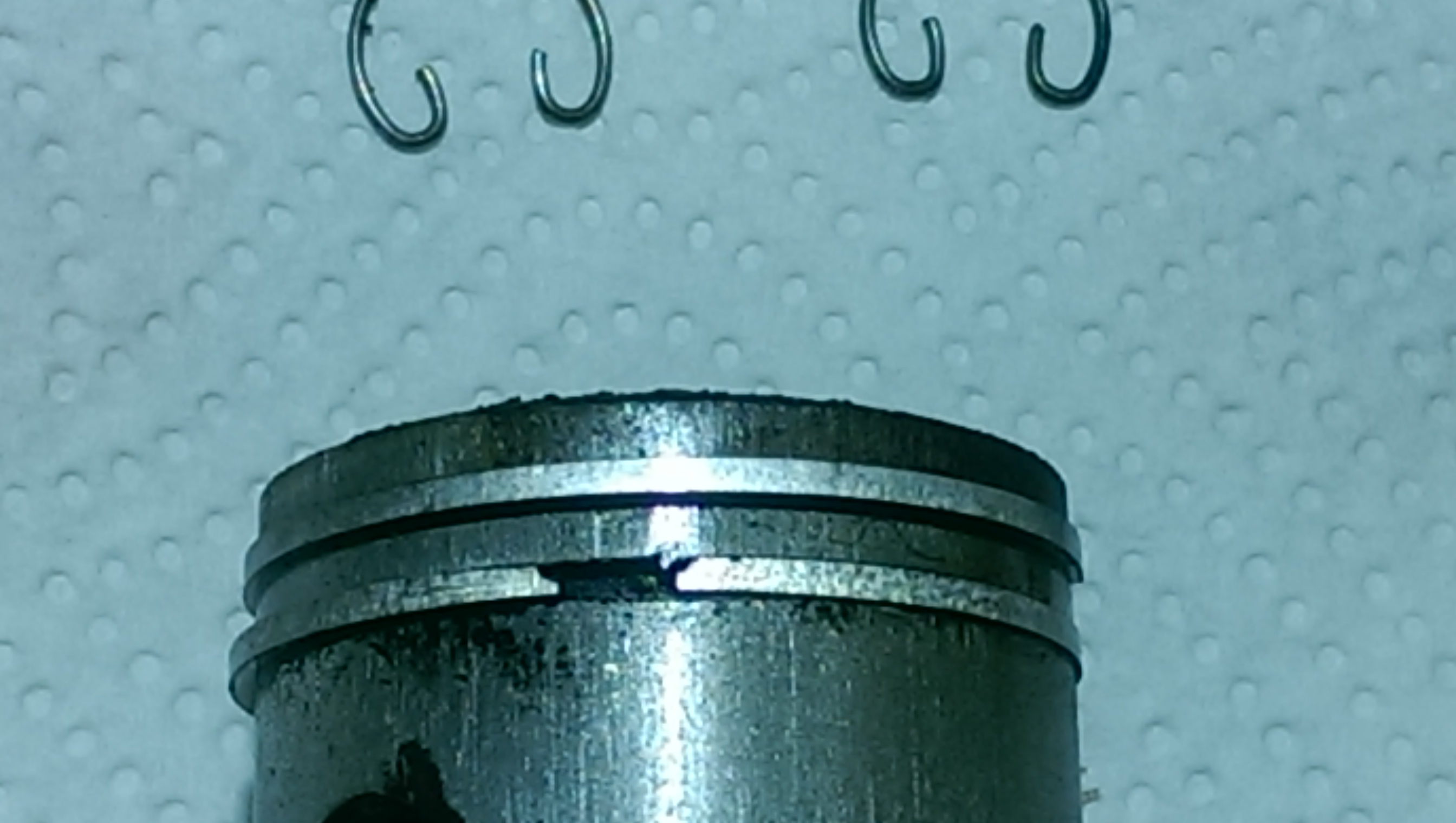

One of the piston rings is also blocked and needs some ultrasound in a bath of RME.

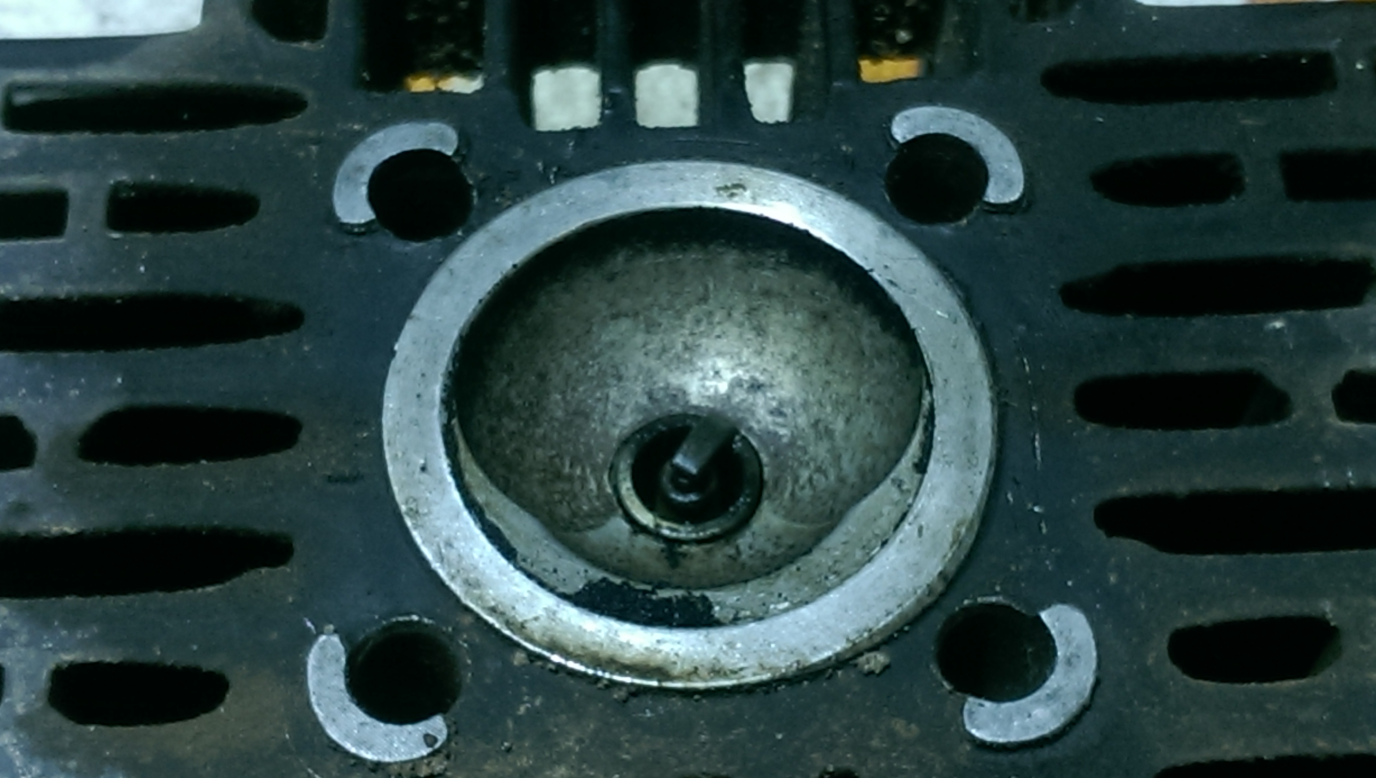

The cylinder head looks as big as a bath tube... That has to be changed.
To be continued...
