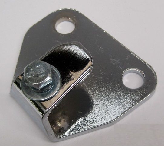

You need an exhaust like this. This one imitates the original looks, but has no s-bend or small front pipe like yours. Only thing you must keep in mind is if you have a euro-1 or euro-2 mounting to the frame (1 bolt or 2 bolt fastening). In the last case, if it's not yet there, you need an extra part to transform from euro-1 to euro-2 like this:
There are some on-line shops which will send to Sweden, like q-parts. Of course there might be cheaper ones, but this is one I found quickly and has possibility to send to Sweden @ 15 euro.
